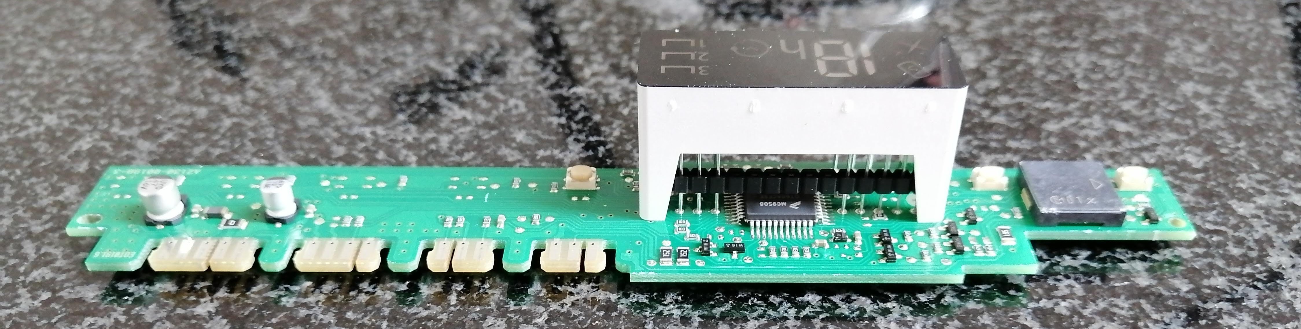

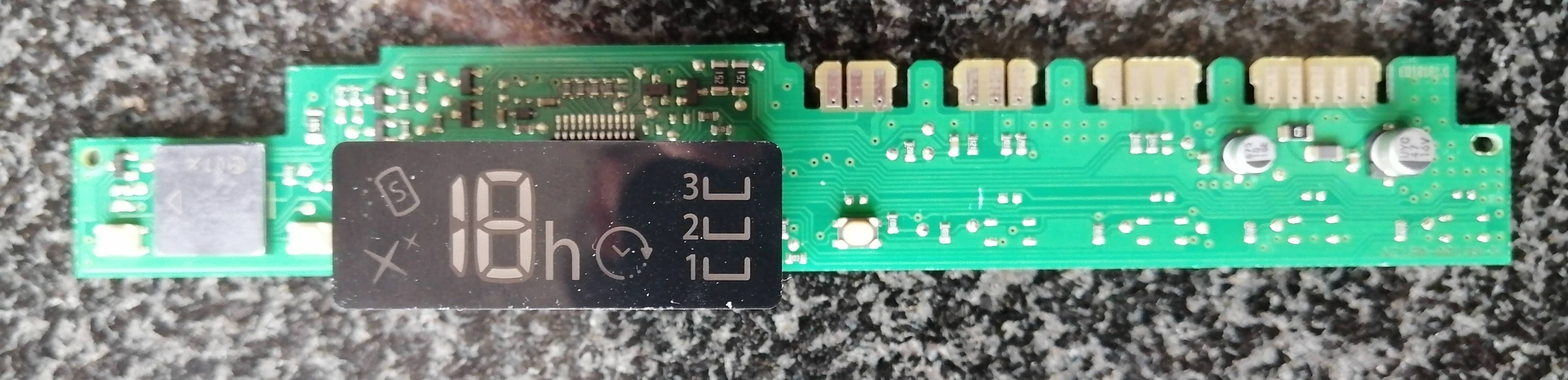

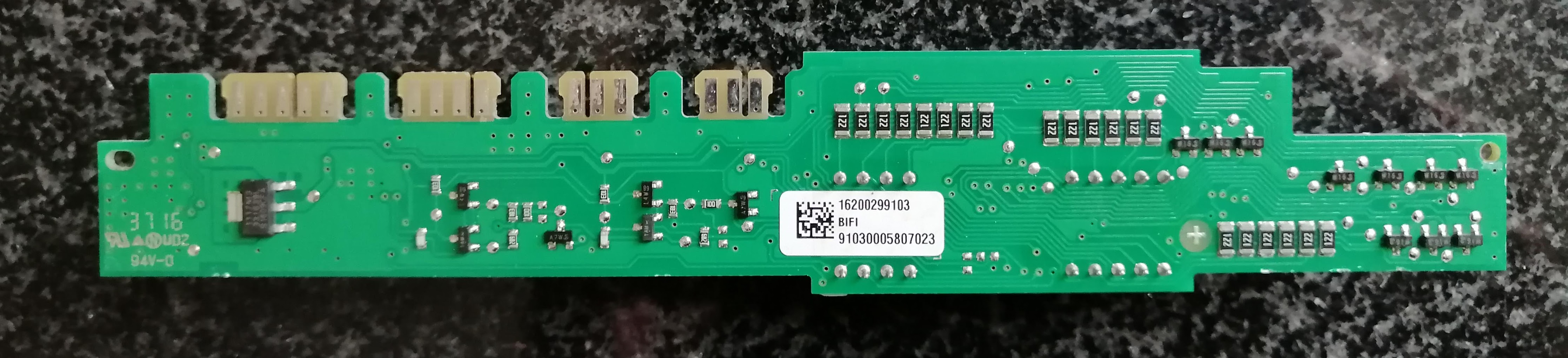

I have an Indesit EDIFP28T9AEU (36867101400) dishwasher and since yesterday it does not power on. No lights or beeps. I checked the power socket and that is working. I also removed the front panel expecting to find a fuse but I can't see one.
The circuit board for the switches looks clean and the joints look good. The wires look in good order and there is no trapped wires.

Let me see some pictures of the circuitboard, both sides.
i think there are 2 components damaged.
You can chance those components if you can soldering.

Hi Bennie and thanks for the response. The only circuit board I can find in the door panel is the one that I've set picture of attached. I was expecting a larger circuit board with more components.
Maybe it's located somewhere else in the machine?
I have a soldering iron and de-soldering tool if needed to remove components.
Thanks again for your help and guidance!

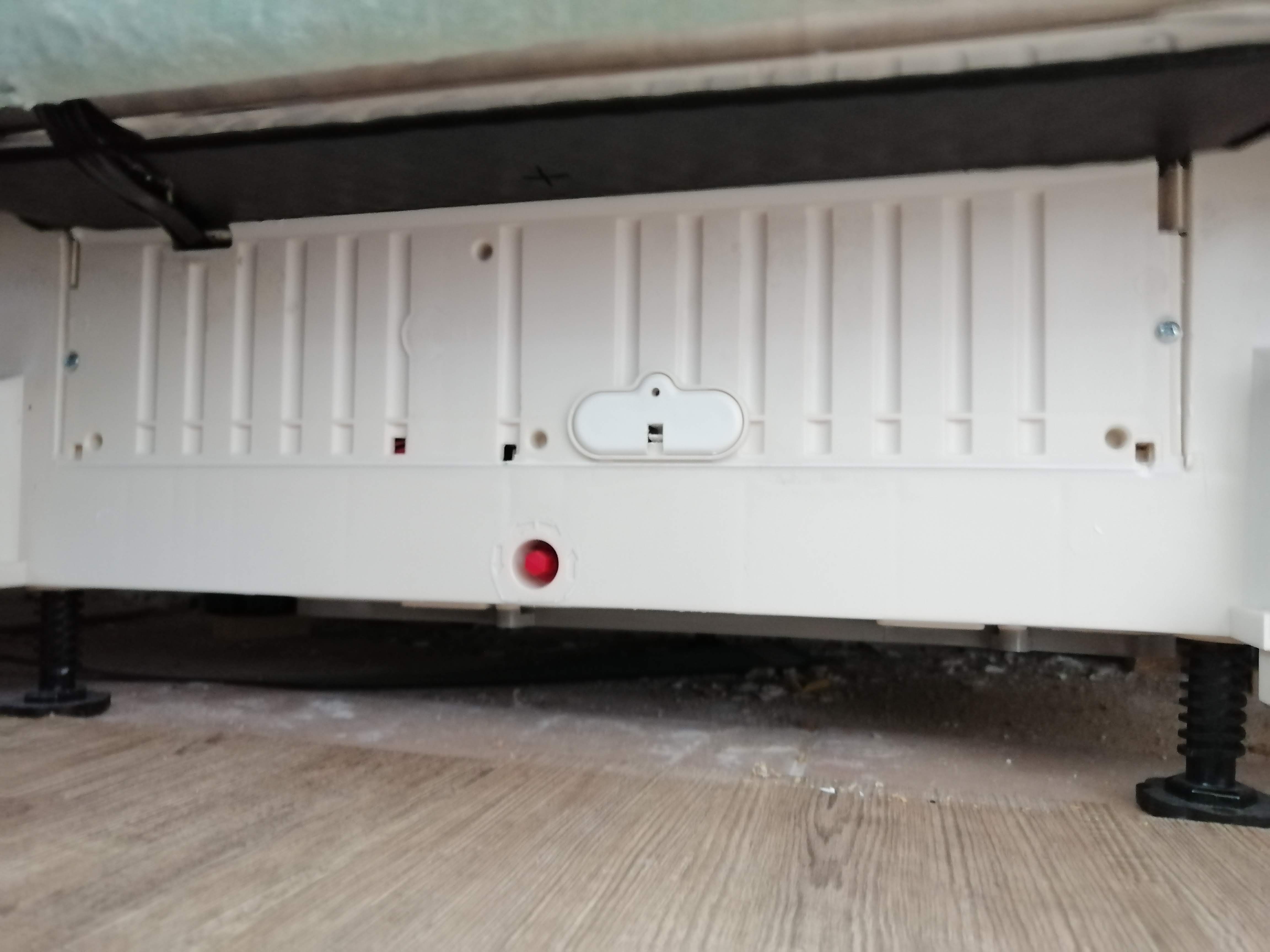

Do you think it's behind this panel under the sound proofing? I removed the two screws in the picture but can not get it open yet.
Seems to be sealed at the bottom and stuck behind a door seal at the top. Any thoughts?

Its on de right side behind the dishwasher.
You have to remove the dishwasher from his place and remove the sidepanel.
Then you see the other controlboard i think.
